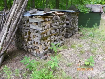

    Well, my stacks are not perfect by any means and are not as pretty as some but we do get uglies. Here is a picture showing what we do with the junk wood. Throw it on top to hold down the covering. You will also notice the poles. Those are what we use under the wood stacks. I've since moved those to where we will be stacking this year's wood. Some of the smaller poles are just thrown on top too to hold the roofing down.
