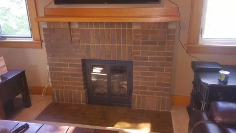

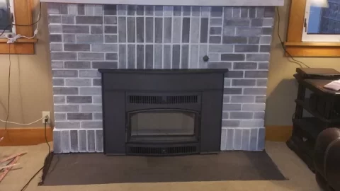

Had my open fireplace concerted to an insert. Lopi Cape Cod. Seems to heat very well but we're not too cold outside yet. Having a hard time to get really good secondary combustion. I get alittle but nothing full bore.
Using 5+ year seasoned Ash that seems to right around it's equilibrium for my zip code of 13-16% water content.
I do get some wind noise while it's in use and when it is not in use. Not sure what that would be from. Basically you can hear the wind outside howling by the insert. Love the look and will be spending every night learning, watching, tending.
Edit: Bricks were stained using dyebrick.com products.

Very interesting brick treatment. Is that paint?
Don't worry about the lack of secondaries firing. Wait for it to get cold, make sure your wood is try and then try again.
Looking good!
I would like to white wash my brick also. Ive read some thin paint. Im just scared ill mess it up and wont like it!
The way I understand it it's not paint. It's more of a silica product that bonds with the brick. I guess they've been using this stuff on exterior brick in Europe to match colors from old brick to new brick and it is still working.
example: (broken link removed to http://www.dyebrick.com/gallery2/v/after-many-years/sheerness/dyebrick-1994.jpg.html)
It goes on like waterpaint.

I just got done whitewashing mine this weekend, I watered down some beige paint and did the cloth dabbing. I didn't want the white look, just wanted to dull down the red brick.
What kinda paint ya use? Any problem with painted brick near the insert? I wanna go for the washed out look myself, not a full white.
I cleaned the brick first with that rutland brick cleaner stuff on the dark spots, then I just used regular paint and watered it down.

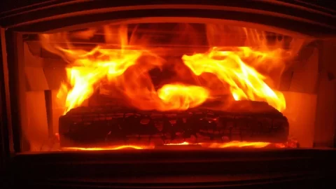

here is mine from last night.
I go from fully open primary at 17-18 seconds in and then pull it completely shut.
Does your baffle plate get red at all? I've had some small sections (at most 4 inches) of certain tubes get red, but didn't think the baffle plate should get red? Sometimes I dont think I'm getting it hot enough and then I see it glow and think it might be too hot. Due to my install and having soldier brick that sticks out a half inch at the bottom I have a 1/2 inch gap between the original firebox top and the top surround. I can see and get an IR meter to hit the top of the insert box and at the very bottom of the flue liner and I've never seen higher than 300 degrees, yet I'm getting glowing internals (tubes and baffle plate)

When I bought my stove I emailed lopi with some questions about glowing internals according to the nothing should be ever glowing. I had the tubes glow on me. I don't think that the plate ever did sometimes it looks like it does but I think it's more of a reflection of the coals. I read me temps with an IR gun on top of the door. On the body of a stove to be exact between door and the grill. The highest I had seen was 480 but that was with the fan on so I figure it was about 200df less than an actual temp. According to lopi this stove should handale 800df. Fro. Your video it looks like you get most of the flames from wood. I have my tubes blowin a river of fire. I will post a video when I will figure out how to. I think what you are measuring is a temp of the shroud. The outside of the jacket around your stove. That would be not accurate, but I might be wrong. How is your wood situation? This stove performes great with dry wood.
prezes,
Both meters I have show anywhere from 13-18% moisture. Most of it is 13-16% Ash that is 5+ years cut/split/stacked. I'm measuring the true top of the actual insert, not the trim surround and cannot get above 300. Door reads upper 400's. If memory serves be correct the temp of the stove between the door and the fan grill is in the upper 300's. With small amount of secondary flames coming of the tubes I dont think i have it hot enough, yet it's still glowing.
I have 24 feet of single wall flue with a cap and insulation on the top of the chimney with one layer of insulation at the bottom of the chimney near the original damper. Outside wall fireplace/chimney. Outside temps were around 40 degrees during this video.
