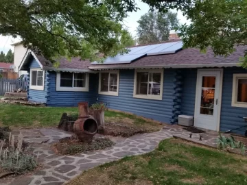

i have used a few methods.... some involve an excavator and making giant holes in the yard, some have involved a landscaping axe, but last year when we clear cut a bunch in our back, I left most of them up, with the intention of hitting them with the dozer. That didn't really work out as planned, and they all started to grow sprouts (crappy box elder!) This spring I need to do some work on the stumps, but due to where they are, I didn't want to tear out the root balls, because it would most likely take half of my patio with it! We have stump in the front yard that we put flowers in. We also have a lot of stumps right up against the house or the fence that I can't get a stump grinder in. They are also mostly surrounded by rocks, so i think I will have to get really creative.

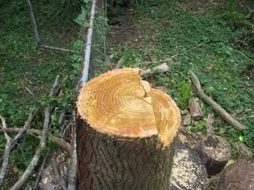

If you can cut off those stumps a couple of inches shorter, just apply a little Tordon around the fresh cut immediately and you will never need to deal with them again. I cut this mulberry last summer and applied the Tordon before even moving to cut my next stump. Instead of 5 new sprouts like I had come to expect, there is nothing growing from the stump.
