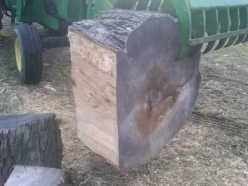

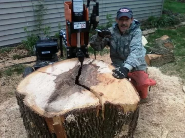

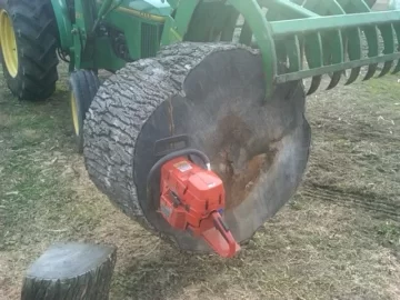

Or maybe the expensive way depending on how you look at. Anyway I was noodling down some big ash rounds and thought it was a chance to explain how I take care of big but logs. For those of you that think just flipping the splitter vertical is the answer I would like to see you scoot a 4' diameter by 24" long cookie and get it on the foot. Took me just a few minutes to have it cut down to manageable pieces.
Since most people don't have a grapple I'll take pictures on my next big job in the coming week. I have a 4' diameter plus oak to take down and I won't have the tractor their to help me. But there is a technique to tackling those big rounds without the aid of hydraulics. Its just a little slower.
