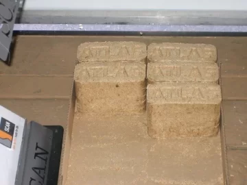

    Actually, on third thought, those bricks look a little like hashish. Maybe it's that blond lebanese stuff headed back this way......
