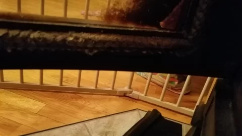

Hmm. I just tried the dollar bill test around the whole door and it was fine. I do see the gasket a little thin on this bottom side. Not sure how to tell if that's the problem.

Hard to think that any smoke is leaking at the bottom of the box, especially if the gasket is tight along there. Maybe creo smell through a soaked gasket, though? At the same time, hard to imagine "creo smell" getting to different rooms of the house. Creo smoke, maybe...
That's why I was thinking an incense stick can reveal any leaks in or out. Can someone explain how the smell could get out of the stove if he is reading vacuum on the indicator?
Spacebus, remember there is a very strong flow blasting the lower corner of the door gasket. That could easily make up for the overall static vacuum pressure I'm reading. An incense stick could be a good idea I guess. Or some other gas dye. It's not just a big pressure tank under vaccum. It's a complex dynamic environment of swirling smoke and creosote.

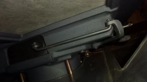

When I cruise my stove, I don't think there is any air "blasting" anywhere in the box...the opening through which air can enter, at the lower right of the sliding plate in this pic, looks to be less than the size of a 1/4" drill bit.

Corrected, air opening is at lower right corner of the plate in the pic.
