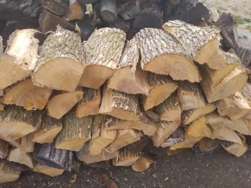

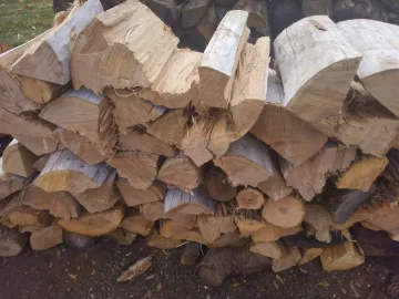

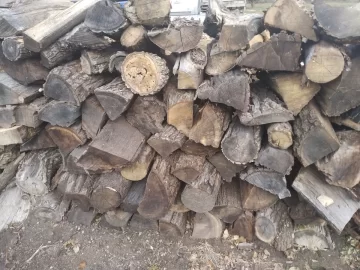

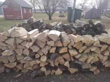

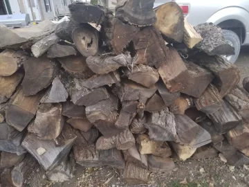

With the new Blaze King 40 up and still warm here Im looking at my wood pile.. MY Buck would BLAZE thru anything you threw at it. I've been doing a lot of reading on the new BK40 and it seems its a lil picky, so I bought a moisture meter, The light stuff you see with no bark is on the money at 20, no if and or butts where I split it, I get 19 or 20, the yellowish barkish wood is anywhere from 20-23 reading and of course the darer stuff is at 15-16. And I guess my only concern to is the size of my splits, Again the Buck would devourer this stiff in a heartbeat, please any feedback on the size of the splits or moisture in the wood working with the BK40.. Thanx

If the moisture readings are taken after the wood has been resplit in half, on the freshly exposed, inside grain of the wood, then most of it should be ready to burn. The BK40 will sip on this wood as compared to the old Buck.
I'd get that wood off the ground, preferably into a woodshed asap. Wood on the ground is going to have a higher moisture reading. Often a lot higher. Is there more wood? This amount would not take me through a winter.

OH YA I have a crap more wood,, at the end of season I move the bottom to top. I did split each row and check with pin tester. We get sub zeros here -50 windchills .. I really hope this stove lives up to the hype.. what about the size of the splits?

I think you'll be much happier with <20 pct wood than with the 23 pct wood.
But it should eat the 23 pct as well. (I think the testing was done with 20-25% wood. Should be listed in the manual.)
I concur; get it off the ground. Pallets, or stringers. Otherwise the bottom foot of your stacks will just suck.

I do burn very large rounds. However, I'm testing this winter and burning the NIELS only for the test. So long as you have a hot coal bed, you can load for bear. I agree with BeGreen, get the wood up and under cover. Get a bunch of pallets. Make a floor, side and back walls all out of pallets. Run 2 x 4's down inside the pallets to build a strong wall. This design allows for lots of air circulation.
Then, find a few 4 x 4's make a tilted roof (running to the back) and get some tin on the top of OSB. You can build this in under 8 hours, hold 6-8 cords. An employee here got a rubber top off an RV trailer that was in the wrecking yard. That stuff is TOUGH and thick. he laid that on the OSB and it turned out great.
