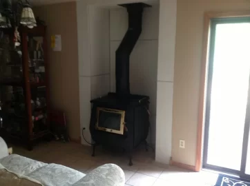

Thanks everyone for the advice...my install is complete...

Congrats. Make that "almost" complete. I don't see a warm glow in that beast yet. ;)
Were you able to maintain 6" clearance for the stove pipe? I suspect that upper back wall is going to be hot.
The back wall is Durock with Roxul insulation. Also, there are no studs within 8 inches or more.
The warm glow is still a few weeks off. Amazingly, tomorrow in Southern Minnesota it is supposed to hit 94!
It certainly looks tight in the pic, and it is. The sides are right at code limit. Still, the back is pretty far off. It is about 11 inches whereas code is 6 and much of the stove is somewhat out of the cove, so I'm not concerned about the cove walls.

Is the durock on wood or metal studs?

The durock is on wood studs. . . 8.5 inches on either side.
It may have been covered at some point, but what is on the walls around the stove? It looks like limestone slabs. I like it!
Granicrete on the walls over the durock.

The inspector told my father-in law that he was very impressed with the install (I was at work). That was nice to hear.
