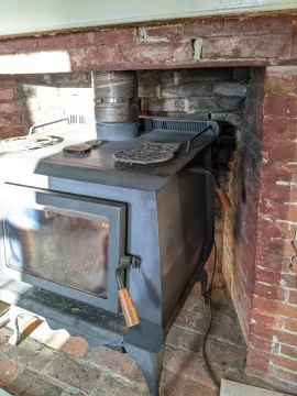

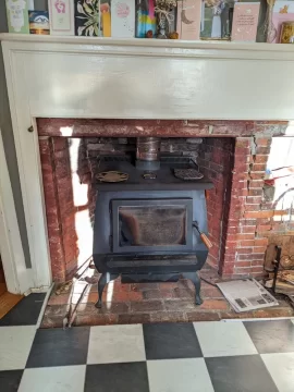

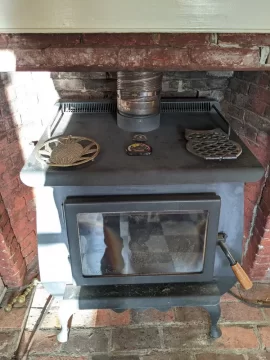

See the pictures below (sorry about the glare)

Supposedly, there is a minimum distance you want the back of the stove from the masonry. Too close and it messes with the thermostats function. Yours looks close.
How tall is the chimney? Is that liner insulated? If it’s too tall you could be overdrafting.
The paint on the face looks faded like it got hot. How are your bypass gasket retainers? Still flat?
The door gasket must be from BK. There is no equivalent as you found. Leaking air will accelerate the burn and damage that new catalyst.
Lastly, sorry about the list, you need to pack this thing full to get 30 hours. All the way full with dry wood, proper draft, and no air leaks.
