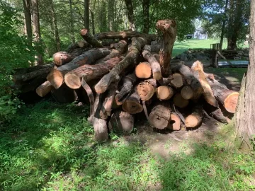

I did burn four cypress trees and one hemlock, recently, if that counts. I pushed them whole into a pile, and burned them in the back yard. [emoji41]
I just split a walnut, and a hard maple, both of which fell in my next door neighbors yard and needed disposal. That’s about the closest to soft wood that I’ll ever take the time to split, with an essentially-unlimited supply of oak, hickory, and maple that I can’t find enough time to split already.
