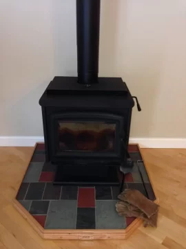

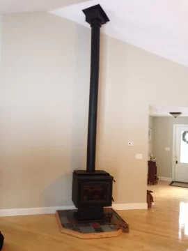

Here are a few pics. Next year we are getting rid of the hearth pad and going to install blue stone for the base and some sort of backing (stone) all the way up the wall to the ceiling. I like the stove a lot, very easy to use and the house is so much warmer!

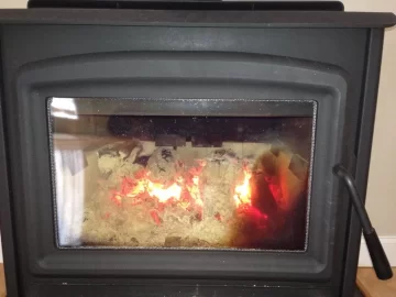

While your stove is cool I suggest doing the dollar bill test on your door. Looks like you may have a leak in that lower right corner or it could just be a typical BK dirty glass?

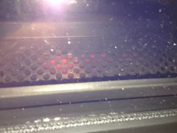

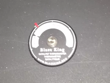

Is that cat glowing that much with the cat temp being on the low side?
If it is that is better then I can do. In other words,were those pics all taken at the same time?
Yes, the pictures were taken at different times. The picture of the CAT glowing was taken at a different time than the thermometer.
I will try the dollar bill test and see what happens. New stove (less than 2 months), so I hope the gasket isn't already gone on it. When I do burn low and slow the glass gets real dirty, but when I burn hot it looks great with just a hint around the corners.
