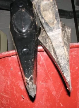

I bought this Truper maul from Baileys, and I HATE it. http://tinyurl.com/3hzyku
When I swing it, it just bounces off oak. My Home Depot Ludell maul just slices right through the same log. I'm sure it's the shape of the head. You can see from the attached photo, the Truper on the left has a thick tip with about a 90 degree tip (look at the shadow). The Ludell, on the right, is much more tapered, and then flares out about 4" behind the tip.
Does anyone have a good experience with the Truper? Am I doing something wrong (again)? :)

You need to sharpen the one on the left and it will work alot better.Take a grinder to it and hog it down! I think they sell them that way for safety reasons.
When it first arrived, the very tip is sharp enough to cut yourself on, but after two or three strikes, that edge was gone. So it wasn't very safe when it arrived. It's much safer now that I've struck logs four or five times before giving up on it.
I would have to grind a heck of a lot of it off to make a difference, and I don't own a grinder.
Of course, sending it back is hardly worth the cost of shipping.

Robin the mall on the left has to be ground down imo...about time you invest in an angel grinder too. Use your neighbors grinder in a pinch. Splitting mauls don't have to be axe sharp just sharp enough to get a bite into the wood and unload all the energy at the point of contact.
