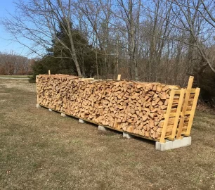

Edited to add pic from the solar kiln thread:
[Hearth.com] Budget shed
Note how he supported the ends and has it up off the ground. Pallets underneath will work but will eventually rot in time compared to the above.
