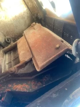

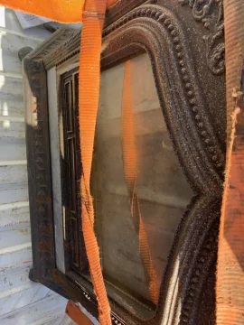

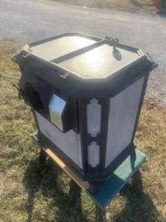

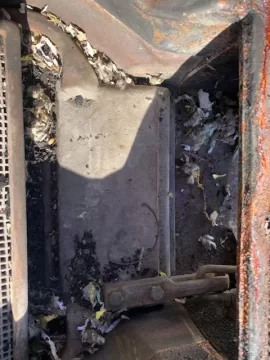

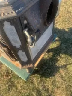

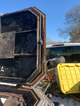

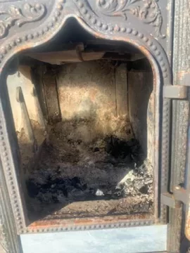

Good day! I have the opportunity to buy this Woodstock Fireview and am lost about what to look for. The price is $1,000 delivered, I am curious if this is a worthy price. From what I know of, it looks good but just dirty and a tad bit of rust that needs a good scrub. Thoughts? Please note, I am not familiar to wood stoves and just bought a property in which I will be installing one. I am not 100% sure what to look at regarding over burning, etc. Sorry for some blurry pics, they are not mine.

Send WS an email with these pics attached, see what they think...I'm betting that price is high for the condition

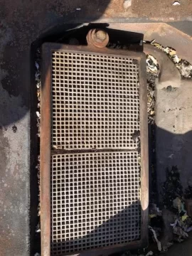

It will need a repaint after wirebrushing the rust off of the frame. This can be done with masking and a brush. Internally, one needs to make sure that the bypass mechanism works properly and that the cat combuster holder is not warped. This one looks dirty, but not terrible.

WS does rebuild them, but at $1k he is asking top dollar for it, I personally wouldn't pay that for it, I would be in the $700 range for it if everything checks out.
The cat is $160 alone from WS, it looks like it needs gaskets all around as well.

Thanks for the help so far! Just talked with Woodstock for awhile and they went through all the pictures with me. The lady on the phone said she thought it looked pretty good apart from the obvious. Looks like if I wanted to upgrade all the main parts to make it run like new, i'm looking at around $400 give or take a little. I was able to get it for $800 as long as I pick it up which is no big deal. So let's say under $1300 for a beauty and some elbow grease for the rust, I would be pretty happy. Also, good job on Woodstock for having an incredible customer support team. If I pick it up, I will post pics and show restoration progress.

talked with Woodstock for awhile and they went through all the pictures with me. The lady on the phone said she thought it looked pretty good apart from the obvious....If I pick it up, I will post pics and show restoration progress.
Yep, looks OK from those pics. If so, that's a decent price. My hunch is that this stove hasn't seen heavy use, just sat for a while and got a little surface rust. The seam cement looks intact, what I can see of it.

That ceramic cat ( and old cast iron cat scoop) looks OK, and I'd see if it works first. Although Woodstock only sells steel cats now, you can get the OE Applied Ceramics cats from Firecat/Midwest Hearth. I haven't tried a new steelie, since Woodstock started making them in-house...I'll do that when I need a replacement for the Keystone.
