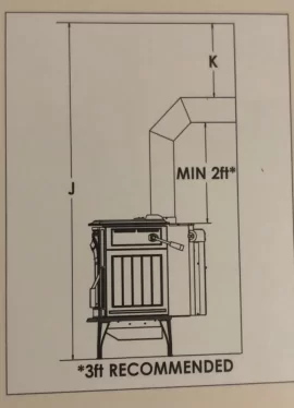

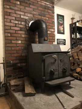

I have a question regarding the 2 pictures below. The recommendations for the vertical rise to the horizontal flue pipe for the BK Ashford 30 are 2ft minimum (3ft recommended) but as you can see from the other picture of my stove that there is only about 16 inches from the top of my current stove to the horizontal pipe. So is the BK Ashford 30 not an option for me anymore? I’d hate to install a stove not to the mfg specs and have a warranty issue because of it.

I have a question regarding the 2 pictures below. The clearance recommendations to the horizontal flue pipe for the BK Ashford 30 are 2ft minimum (3ft recommended) but as you can see from the other picture of my stove that there is only about 16 inches from the top of my current stove to the horizontal pipe. So is the BK Ashford 30 not an option for me anymore? I’d hate to install a stove not to the mfg specs and have a warranty issue because of it.
I will say, based on the recommendation you can have issues but it is hard to tell. Most of newer stoves share similarities on flue setup recommendations. I know, it is an expensive trial and error.
Maybe someone has a similar setup as yours and can give you better input.
Dave. I see you have an 8 inch flue. It was recommended to me by several dealers and one called blaze king to confirm, to not reduce the 8 inch down to 6 inch for the Ashford or princess. Reasoning was that since the flue is not that hot when it expands into the 8 inch it would cool further. So I ended up with a King. You might want to check into it with your dealer.

Although the King uses 8" it also needs 3' of vertical pipe before going horizontal. A consideration in Dave K's setup.
