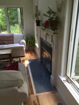

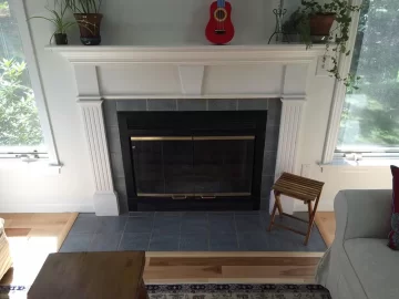

We just moved in to our new house, and we're ready to convert our zero clearance wood burning fireplace insert to a nice radiant soapstone wood stove.
I'd really like to avoid removing the insert, because from what I can find online, that's a HUGE project that could involve ripping apart the walls, sometimes removing studs, sometimes cutting through the exterior siding, etc...
Here are some pics of our setup:
Front:
Side:

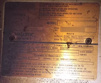

Model of Prefab Fireplace:

When it comes to a pre-fab fireplace like you have things can get complicated. Many people on here say it's a bad idea to alter a fireplace like this in any way. And will tell you not to.
You can drop an insulated liner down to a Tee and hook a stove to it. You will need to extend your hearth first though. Make sure it's ok with your insurance company before you do anything.
For the record, you don't have B vent chimney on that fireplace. If it were B vent then you could not do this.
madison
As above, plus you are going to end up extending that hearth way more than your photoshop picture tends to portray.
I would at least get a reputable installer to estimate the removal and consider potentially a wood burner insert or fireplace which there are some recent conversations here.

Well I will start off by saying that the manual for your fireplace clearly states that you cannot modify the fireplace in anyway and cannot use any components with the fireplace not designed to go with the system. That being said I think you can safley install an insulated liner in it and set a stove infront of the fireplace as long as.
1. You fully inspect the entire system making sure it is in good working order and it was installed to manufacturers specs (many we inspect were not)
2. You do not block the airflow around the firebox or through the air cooled chimney in any way.
3. You extend the hearth and make sure it meets the required r value for the stove you will be installing.
4. You meet all required clearances to combustibles for that stove
And no you absolutely cannot put an insert in that fireplace. And what you have is not an insert it is a prefab fireplace commonly known as a zero clearance fireplace (which is very misleading because it does need clearances to combustibles)
