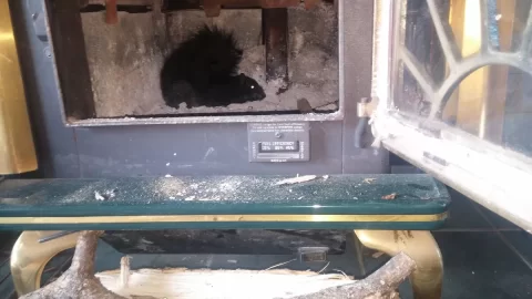

Here's a photo of it from last year, and a couple of an effen squirrel that managed to climb down the flue and into the firebox!!! Crazy little booger....but like the saying goes, "If you're gonna act dumb, you better be tough"
