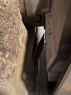

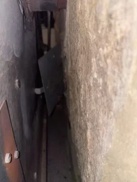

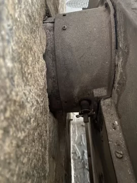

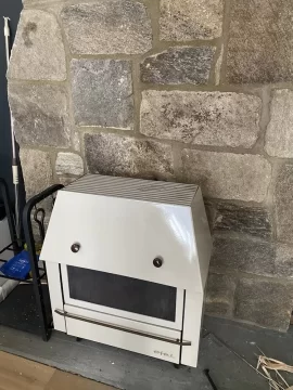

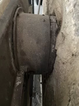

There is also a door, about 12" or so below the flue going into the wall. not sure if I should open this. Here are some pics and how the manual shows it

bholler
Chimney sweep
Staff member
Jan 14, 2014
31,982
central pa
Cleartron
Nov 18, 2021
14
Norwalk, CT
Close and seal the cleanout door
Thanks for the reply. It’s always closed. I only opened it for the picture.
The guy who cleaned our chimney thought it might be a clean out door, but it’s just a cavity that was probably going to be used for that purpose but never implemented.

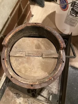

I have a donor stove I took apart that I got for free on Facebook. I'm wondering if the collar seal needs to be replaced. You can see remnants of one on the donor parts (attached). Not even sure where I would get such a part.

Might be overthinking just a trifle here. That is a full on flue damper, which when fully closed odstructs the flue like 90% or more. It may be that you simply can't obstruct the flue that completely, indeed it's not necessarily intended for that under normal operation. Use it
I'd be tempted to trim the damper a bit more so that it admitted say 25% of the flue gases when closed. This could be done by cutting it or drilling some holes to equal that amount.
