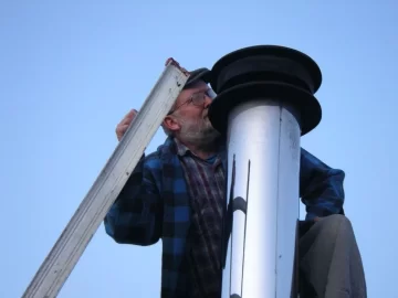

This is real world conditions temp minus 5 c ! Jetstream gasification boiler at full output air is just hot enough to be uncomfortable to breath , the air smells no different than the air that would come out of a furnaces hot air duct .
