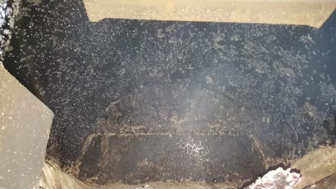

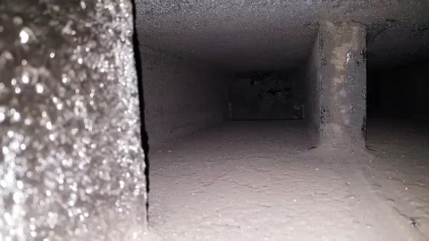

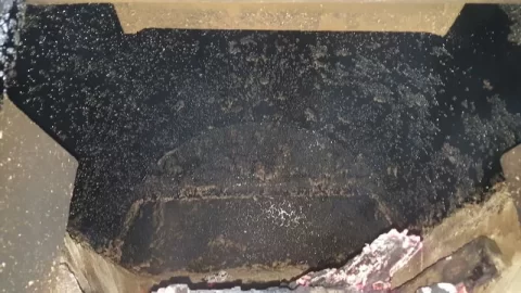

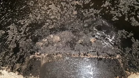

warno, post a picture of the accumulation please also let us know what you did about your situation please. i am with maple1
I haven't done anything about it yet but I'll try to remember to get a pic when I put in the night load. I have been trying to let it burn down a little more then let it burn hot to catch up on temp. The coating inside gets crusty and flakes off but I was just wondering if there's anyway to really get it cooking.
So I got some pics but they aren't that great because I wasn't going to stick my hands in the firebox with a toasty bed of coals roasting away in there.
So here's the pics
Top and back
[Hearth.com] Cardboard to burn out creosote? OWB

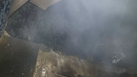

Side wall. Sorry about the smoke in the way but you can see the coating I have.

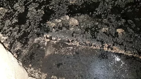

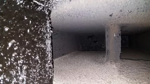

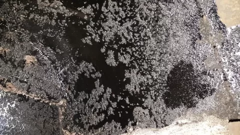

Hard to tell from the pics, but I don't think that looks a whole lot different than mine.
You could try the cardboard thing, I don't think you'd hurt much. Especially if you do it in a cool boiler that had more room to absorb heat. The biggest risk I would anticipate is having someone call the fire department on you when they see all the smoke.
I didn't try the cardboard but I have been letting the boiler cool down about 20-30 degrees when I do my weekly cleaning, then fire it up and let run full on to dry up the creosote in the fire box some what. I can scrap most of it off with my coal rake after that.
I'm wondering though, next year when I start batch burning to heat storage will it dry up the creosote that I'm building this year?
This is the top and baffle in my fire box

Here's one of my sides

Another of the baffle

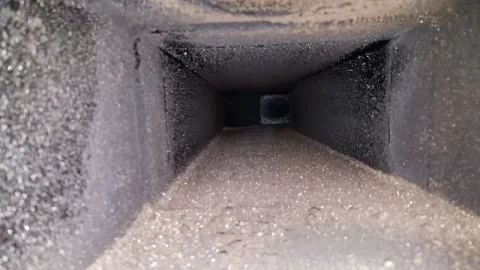

This is the HX

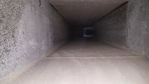

This is after a cleaning in the heat exchanger
Could I expect less creosote when I start batch burning next year?
