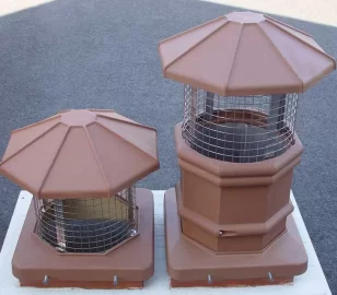

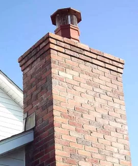

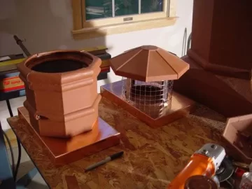

Back on topic a little bit. I was thinking about why chimney caps are so plain jane. How come manufacturers don't have copper caps or add on fineals (sp) or more decorative caps. Perhaps I haven't looked hard enough.
-Kevin
I KNOW you've seen my proper toppers....
http://www.extendaflue.com

I was just at a home show this past weekend and saw some pretty nice caps. Copper included. Very decorative with different styles of mesh for a different look. I even saw a spring loaded cap that can be pulled down against the flue by a chain to keep the critters out/stop the draft.
