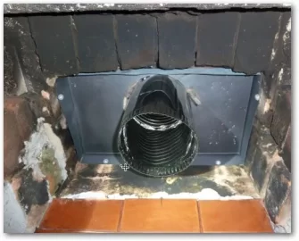

I spoke with a "fireplace expert" at one of the major FP suppliers. He explained I could remove the damper, run a SS liner, then I would have to have a fireplace blocker fabricated. It would have a hole in it that would connect the flue to the blocker plate. He said there was a ton of DIY videos on it. Well, he lied. All I could find is FP Registers. I attached a picture I think is what he was describing. However it appears this technique is only if attaching a stove which I do not want to do. Does this clarify?

That's a classic pic of a liner with a block off plate ready for an insert.
I think that's what you want except the plate should have a "peak" in it (smoke chamber) and the liner should be flush with the top.
Yeah i have seen half ass installs where they used a metal plate like that. But it is not a very good way to do it. You want it tied in with masonry. You also need to be sure the liner is sized properly. And it should be insulated. And after all that work and moneu it still wont make any heat.
No you dont want a metal plate.
