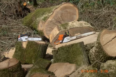

    Yep and mine does. It blew through this thing easily enough.
