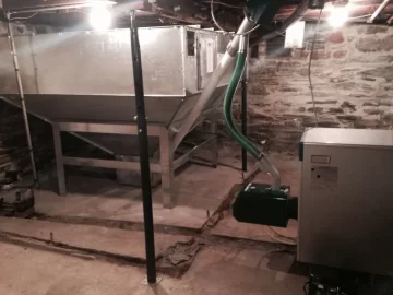

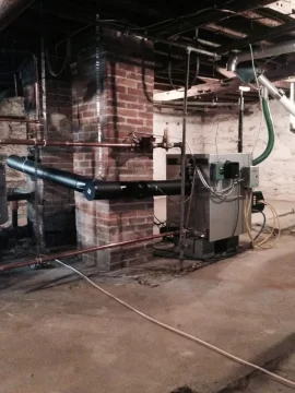

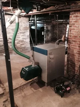

Getting my pellergy pellet boiler installed tomorrow and can't wait. Have my first 3.5 ton bulk vermont softy fill up coming later in the week. Pics of the bulk bin (not as easy as it looks to construct) and exterior fill (broken image removed)(broken image removed)set up below. Boiler pic coming soon.

There any discount buying bulk by the ton ?
With vermont wood pellets it will end up bring around 25/ton cheaper than bagged delivered. But for me it is mostly the convenience of never having to handle another bag again. Delivered and automatically auger fed, saving 50% a year on fuel costs, and enjoying the warmth of my 100 year old cast iron radiators. Life is good! Pics tomorrow!

awesome setup.

So wanted to share some numbers:
November average 10 hours per day and 9 starts which worked out to about 2 ton including my Dhw. About 3700 sqft of living space.
December is going to be a bit higher so far with my system running for about 26 or the past 36 hours. Average temp of supply is about 140 with the Pb. I'm tempted to supplement the oil boiler in conjunction to heat my cast radiators quicker. I think I will tinker with the controls this week. Any way the house has been nice and toasty and have enjoyed not having all the work of lugging bags and cleaning twice a week. I have only cleaned the system 3 times so far since October! Love it!

nice set up, I was looking for something like that for FHA set up, plumbed in to the existing duct work. Keep us posted on how its working out..
