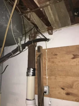

I also can't tell how/where exactly that cast iron pipe runs without cutting a hole in the wall above the face brick. The pipe is waste drainage from the second floor bathroom, which sits roughly right above the fireplace. It almost seems like the chimney is built around the pipe.
