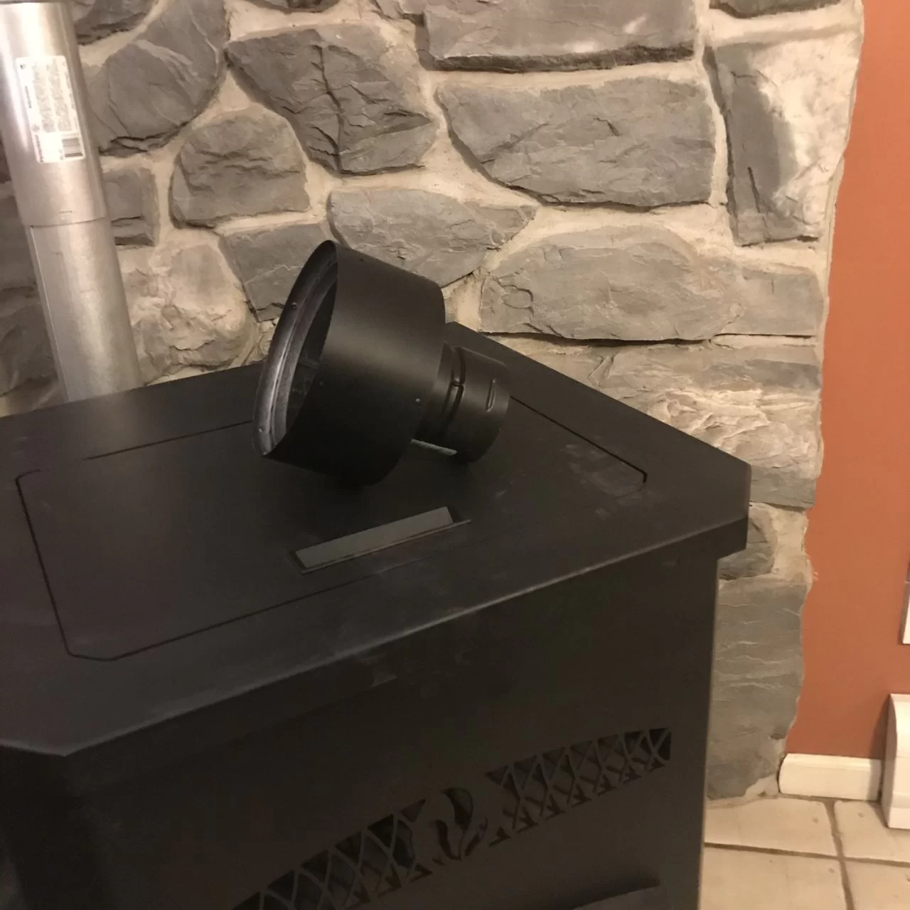

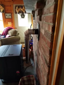

Here is what I did with mine similar to yours seems to be working fine. My chimney has an 8" opening tried a 8 to 6 inch adapter between the chimney and pellet pipe 3 to 6 but it resulted in the stove being farther away from the wall than I wanted. So I got an 8" plug and cut a 4" circle out of it using a hole saw and screwed it to the 3 to 6 adapter with some 3/8'' long #10 sheet metal screws.
Now the caveat's many will say you have to line the chimney with something in the 4 to 6 inch range and they may well be right in many cases,
I understood that but also now several people that have done it in a similar manner with good results so I decided to try it this way and will continue with it until I see a reason not too. It's only been a few weeks but so far so good.
I'm also not using outside air I was planning to do that eventually but it noe a simple thing they way my house is laid out so that may go by the wayside.
Attached are some pics two as it is and one showing it with the adapter.
Anyways that's my story and your results may vary.
