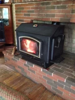

[Hearth.com] Continuation of BK Princess thread which turned into...This is the rusty stove that came from porch with Gardenias on it as a plant stand. It was all rusty brown until he painted it (85 years old and has nephropathy in both feet - cant feel them) . So, here is my first question. Fired it up, got to 350 stove top temp, engaged the cat, (I wasn't sold, convinced that looking at the stack that it kicked off) then disengaged it raised temp more (500) then re-engaged it and the stack was clear. I then at one point looked up and at an angle and could see the cat (s) on the edge glowing red like a toaster. All good. Then a half hour later, temp dropped a tad to about 450, there was no more glow. Any thoughts?

The cats not always going to glow, it's still working even if it's dark and the temps up. Good way to clean the cat during the season is to spray it with vinegar and distilled water then rinse it with distilled water and let it dry.
View attachment 229288This is the rusty stove that came from porch with Gardenias on it as a plant stand. It was all rusty brown until he painted it (85 years old and has nephropathy in both feet - cant feel them) . So, here is my first question. Fired it up, got to 350 stove top temp, engaged the cat, (I wasn't sold, convinced that looking at the stack that it kicked off) then disengaged it raised temp more (500) then re-engaged it and the stack was clear. I then at one point looked up and at an angle and could see the cat (s) on the edge glowing red like a toaster. All good. Then a half hour later, temp dropped a tad to about 450, there was no more glow.
It doesn't need to glow, but 450F is low for an active cat temp. It may be depleted.
How exactly are you measuring the cat temp? Probe should be downstream of cat, centered on face, and within a few inches of the combustor.

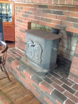

Since I have a Progress, I never get to see the cat while it's active. On this Sierra you can see just the edge and it was pretty neat to see it a bright orange and hardly a fire in the firebox. I'm glad that it doesn't have to glow as the stove seems to be working well and, even without the glow and surface temp at 450, the exhaust smoke was minimal to none so I assumed it was working. He doesn't have a cat thermometer, it's a miracle that he has a temp gauge at all. Remember, he went from this stove with cracks as big as 1/16 " which burned up to 8 cords a season for 20 years. His method of running this stove was basically full bore.Notice no fire pad on the floor and a rickity front loading door.

Funny tale. Many of us have experienced at least one puffback. Makes one glad that there are 3 screws at every pipe joint. He'll get the hang of it if he listens and learns.
As noted, what is not correct with the new install is the lack of a hearth pad extending at least 16" in front of the stove door. That really needs to be fixed before an accident happens.
Also does this install have a full liner run through the chimney?

No, his son, a high end chimney flashing contractor was visiting from Atlanta insisted that an insulated liner be installed. But, understand, this guy burned for 20 years with his Garrison without one. To even begin to convince him of ANY change is monumental, not to mention it would cost more money to install a liner. Now, that said, the son SHOULD have just bought the liner up in his pick up truck (as he gets contractor pricing) and he knew we would be changing out the wood stove after 20 years.
One argument to support him is: this is a massive internal brick and stone chimney. Oil flue basement, first floor chimney, second floor chimney (never used). In the winter, the whole mass is warm. If a liner was used it may not warm the mass as much.
