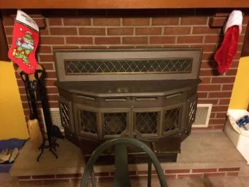

I recently had a Country Comfort insert given to me. It seems to be a very nice stove with minimal use so far. I pulled the manual on the stove and it states to use a direct connect kit on the top of the stove flue up into the chimney flue. The stove I received did not come with one of these direct connect pieces and I cannot find a picture of one anywhere online. My stove has a rectangular opening at the flue with a slide damper. I was just going to have someone make me a direct connect, but I don't even know what size pipe to have this connect to. Any help would be appreciated!
Thank you.
Below is a quick picture of the stove. I can take to top cover off and show a picture of the flue opening on the stove if that would be of help.

I would run a full liner not just a direct connect it will work much better and be much safer. There are lots of places that make adapter boots or you can get a custom one made up.
Do you mean a full liner all the way up the chimney? And what size liner would be appropriate for this insert? Thanks.
that depends on the size of thet rectangular opening it should match the volume of the liner i would guess 7 or 8" but i need to know the size of the opening to know for sure
And the house was built in '68 so I believe the chimney is very sound.
what would make you think that a 46 year old chimney is necessarily sound? That is a long time for weather to take its tole on that masonry and allot of time for the liners to be damaged from heat moisture and corrosive gasses. And you would need an 8" liner to match that opening

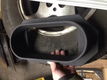

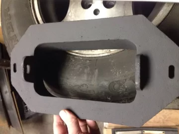

This is the adapter that came with my country comfort stove. Oval must have been popular back in the day. I bought an adapter that I am hoping to connect it to my 6inch liner. If I were you I would have a adapter made to cover the opening into whatever diameter you decide for a liner. I am going to try and use this since I think making the adapter will be speedy.
This is the exact type of connector I will need with my insert. The problem is I cannot find a single store that has a compatible adapter. Does anyone know where I could get one or have one made? Thanks.

In order to use that stove you will also have to buy this: (broken link removed to http://woodheatstoves.com/oval-to-round-adapter-p-17614.html)

Country Comfort went out of business. If you need an adapter and don't have one like mine, I would just get a plate of steel and have a cirle cut into it and a pipe the diameter you need welded to it and then secure that to the stove. The adapter I have is kinda a pain. I bought a Vermont Stove company oval to round adapter, and I am going to have to plug it with gasket tape and stove mortar to fill in the gaps since it doens fit exactly. I am debating just having a round adpater made to avoid the oval design all together.

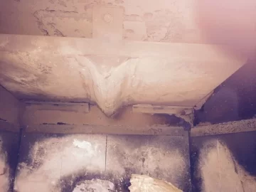

Here is a picture of my baffle.
[Hearth.com] Country Comfort insert drafting questions
Same as mine. That triangle coming down is a secondary burn tube, in the back there will be a hole about the size of a quarter for it to get outside air.
