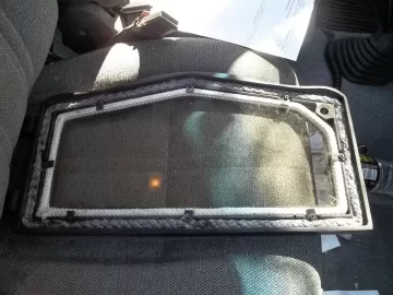

The door is complete now, I'll start a small fire to set the paint this weekend.

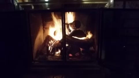

I fired up the stove this evening, I didn't have any flue pipe on hand so the stove wouldn't draw with the door closed. I kept it around 200 degrees for the first burn. Tomorrow I'll pick up some pipe and fire it up again. Still need to clean the brass fixtures and install. Click on the pic for the video.

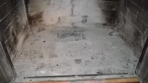

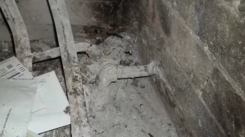

I had the old gas burner tube removed from the masonry fireplace Monday. I still need to order a SS liner kit.

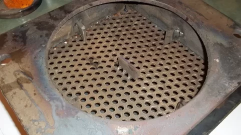

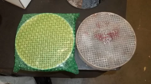

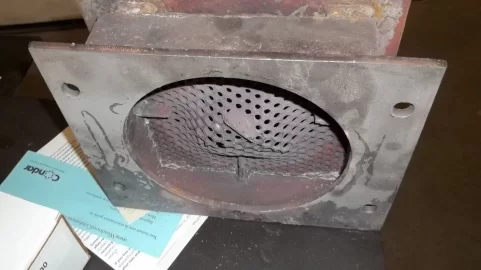

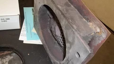

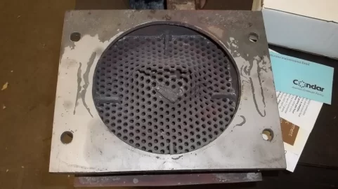

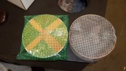

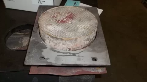

The new cat arrived this week, the cat holder is seriously deformed from heat. I know a steel fab shop that might be able to remove the drilled section and weld in a new piece. I'd like to try and reuse this as I know it fits the stove.

The chimney sweep isn't available until 10DEC, so the install is delayed. I still need to fix the Cat holder. Looks like 6" of snow overnight. We still enjoy this even though the heat gain is minimal.

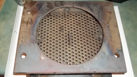

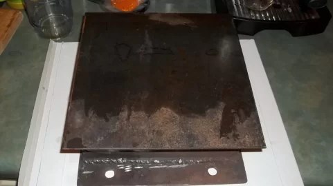

The cat holder was dropped off at the fab shop today, I'll post the "new" pics when I pick it up.
I picked up the cat holder today, the stand-offs might be a little tall, need to check still. So for $60 I received a new bottom piece and a thicker shield, I'm very happy and it's going to be in the single digits tonight.
