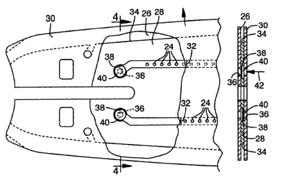

    No hole in the side of the bar? This would be the small circular hole in the side of the bar, to the left of "38" in this image. Oil goes from saw into this hole, to be distributed along groove. If there's any clog in the system... no oil.
    Stripped oil pump gears and failed pumps happen, but a clogged oil channel is much more common.
