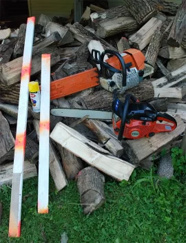

About 5 years ago, there were 3 of us cutting up 2 grapple loads and a few others helping out, after about an hour I noticed some were 23".....some were 18".......etc.....etc....
The 23's fit into my BIL's Firelight, but not to good into our Oslo's. So if we are cutting on a grapple load, I'll use a piece of wood strapping marked at 20" with wood screws. I'll go down and mark 5-6 trucks with paint and we'll have at it.
Quick, easy no BS......smaller diameter stuff we'll eyeball 18" or so, but good sized trunks get marked.
We don't mark all the way around, if your chain is sharp, the bar is good.....your saw should chow right down through.
Sometimes we have the older kids mark them for us, but they have trouble keeping up when the 660 & 5100s are running together.
WoodButcher
  • [Hearth.com] Cutting logs square?
