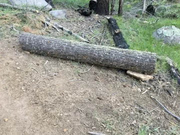

Get yourself a cant hook/ lever:
(broken link removed)
I used it on this Douglas Fir log and it worked great.
