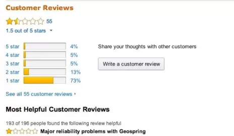

Do some homework before buying a GE Geosprings. They seem to have reliability problems. I've never seen an Amazon rating so low.
Not much better at Lowes.
2 years and my only issue was bad elements because I never used them and ran it in heat pump only mode. GE sent upgraded replacements for free. Even if mine blew up today I wouldn't care as it already saved me probably 20 times the $100 cost in power savings. 500 watts to run the compressor vs 4500 elements.
Not sure where you got that amazon rating from as I searched Amazon and only 2 reviews came up. The lowes one is almost 5 stars.

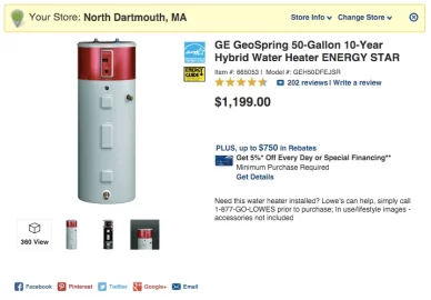

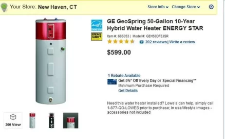

That water heater price in Ma:
[Hearth.com] Didn't Save As Much Oil As I Thought I Might (Year 1)
if you don't qualify for the "up to $750 rebate" you may never recoup the initial investment.
and if you look just to the right of the yellow stars there are 202 reviews, of which pretty much parallels the results at Amazon's one glowing 5 star review and one absolutely dismal review which would be zero stars if Amazon's rating system allowed for such.
With Lowes and Home Depot you can't assume the price you are seeing at your zip code/store is the price someone else will see at another zip code
