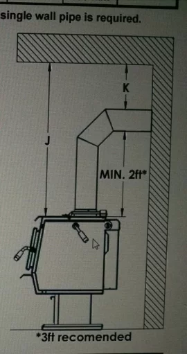

Is this not more in line with what the manufacture has in mind when recommending an installation with 2 x 45° elbows.

Why then not simply use a 90° instead.
Not much rise there !
He is still way short of the vertical rise they want, and two 45s is a little less abrupt than a 90. Pushing the stove to the wall and cutting down the horizontal run will help. Might have to insulate behind the thermostat, though...
It can be ideal after the 2' minimum rise but better with 3' rise and the setup in the picture
