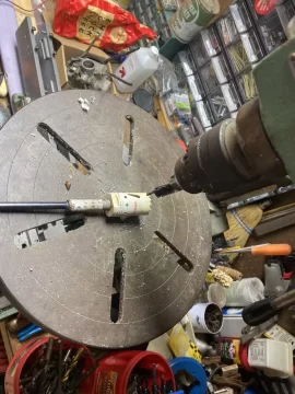

I grabbed an old hole saw out of the coffee can and drilled (8) holes around the base and cross-threaded it onto the end of a rod to be sure it won’t come off. (Same size, different thread pitch)
[Hearth.com] DIY Soot Eater
Next I cut it off, knocked all the burrs with a file, dremel and sandpaper.

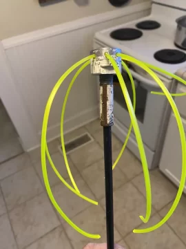

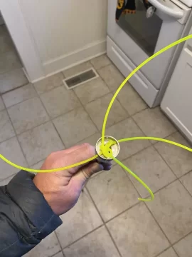

I cut long lengths of string and tied a knot in the middle and started to insert them with the knot centered and the tag end going out opposing holes. I suppose you could go in one hole and out the next to reduce the bulk inside the head. I went with shorter pieces that I melted and mushroomed on the counter top.
I’ll give this a go next time I clean and see if what I already had laying around works.
It couldn’t have been more than a half hour to make including planning and R&D.

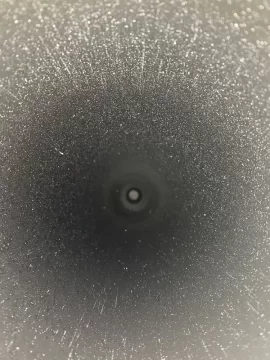

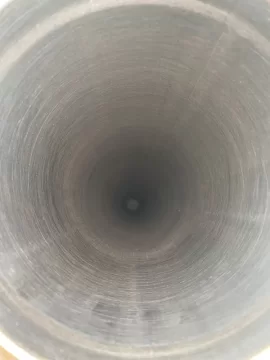

Tried it today. I’d say I wasn’t impressed with the knock off version. Maybe it was my drill speed, maybe it was my line, maybe it was my expectations. I mean if you just want to knock the crud off and slick up the chimney, sure, it did that. I then ran my brush through and got down to bare metal.
Before knock off

After knock off
But the brush brought it back to metal.
This isn’t a bash of soot eater. But my home made rip off may not be up to par with my metal brush.
Would this meet your standards? I’m just used to a brush bringing it back to slightly tarnished bare steel.
Bummer. Thinking out loud as to why yours didn’t work out as hoped:
  1. The Sooteater has groups of five strings together thru each hole, which gives the bundle more stiffness
  2. Uses very stiff string, maxi edge hex .105”
  3. Strings are trimmed short OD - 6.5” to maintain maximum stiffnesss at bundle tip.
I listed them in the order I’d guess are most important, but have no real proof (other than end result) as to which of these matter most.

So, your implying that it should have come cleaner than what pictured? I don’t really know what I should have been expecting out of it.
To be honest, I avoided answering that, because I don't know. I was going more off your disappointment with it, than any visual evaluation of my own. I'm sure others who actually look up their pipe more than me (it's been 6 years since I had my pipe off my stove) can give you a better evaluation on that.
I really don’t know if I was actually disappointed or if it is just a different result than the brush gets. It may be a totally satisfactory result to just knock off the scale and soot, but still not be down to bare metal.

I like the way you think 30WCF. I have been considering making my own 'sooteater'. Your 'after' looks pretty good to me. I don't get that clean with my 6" poly brush on rods when done by hand.

It'll be interesting to hear what others think of it, but I do believe the bundles of 10x stiff .105 string, trimmed to a length just slightly larger than your liner, should give better and stiffer tip action on the surface of the liner, than your long single strands.

I think the length of the strings is the issue. Yours will (have to) slide tangentially against the walls. My soot eater is stiff as ashful said, and the tips will hit the wall rather than having the sides of the string slide along the wall.
