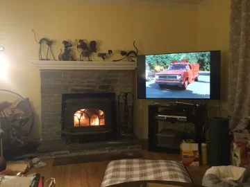

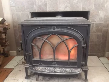

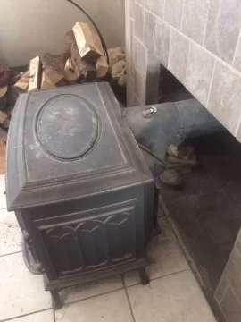

I have been burning wood for heat for about 13 year. I have a large Jotul Woodstove(model escapes me but bought it in 2006). I go through firewood like crazy. I always thought it was because it was a large stove. I generally throw. Log an hour on it. If I load it up before bed I usualy load it again innthe middle of the night about 3-4 hrs later when I wake up to hit the head. I was telling the guys feom work about it and they both said that is way too much wood, are you adjusting your damper right ? I do not habe one on it. It has an air control on the front and I have a magnetic thermostat on the fluw pipe which I use to regualte the air flow lever on the stove. I burn a good heaping wheelbarrow of wood a day. Also as you can see in the pics the only place I can install one would be right out of the baxk of the stove. Opinions ?

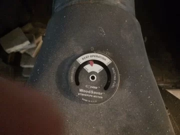

Herea the gauge.

That is indicating something in the 300-350 area - but it's too hot (+599) for your IR gun to measure?
Seems like something amiss there.
Also I think those things, even when somewhat accurate when new, can also go wonky over time, especially if they've seen high temps.

I might have not remembered correctly with the laser. Now Im thinking it was hitting error over 300 maybe ? I’ll try it again later. It was awhile ago I tried it. But that gauge pic was taken when I posted it. I always keep it in the range it says but I’ll see if I can find a more accurate wat to measure it.
