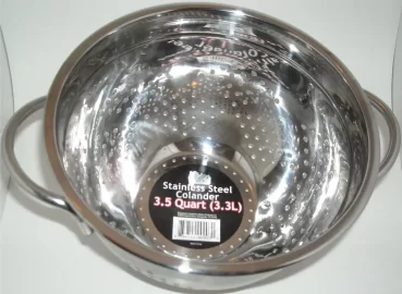

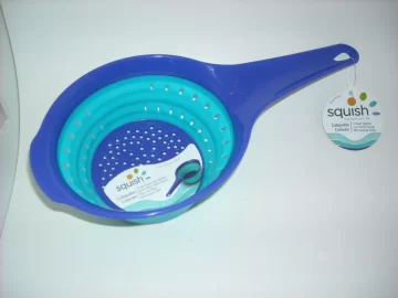

Does anyone use one of these Strainers to keep the Auger Jamming fines Out?

I had to strain my first bag by hand, not much fun LOL!!
whatever ya do don't use a small stariner or else it'll take you an hour for a bag.... I used a similar sized one as the stainless one held up by 2 pieces of 2x4 stradled on a garbage can to pour, then hand siftefor about 20ish minutes... I can see a vacuum rig in the very near future LOL!! ==c
Before I built my system for the shop vac i used a strainer like shown. Worked but took while.

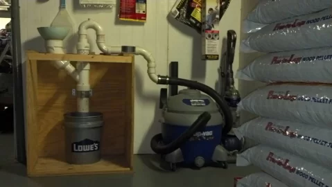

I built the Pellet Vacuum system shortly after installing the stove.
It reduces the dust going into the stove and in the house so the wife is happy.

Leave the strainers to the pasta makers. Make yourself a neat little Pellet Vac contraption.
Just wondering if you have patented this yet or not? Could you share how this works and how to build it? Seriously love the design would love to see do something like this.
Way to much work with a strainer...
Make a vacuum. Easy peasy!

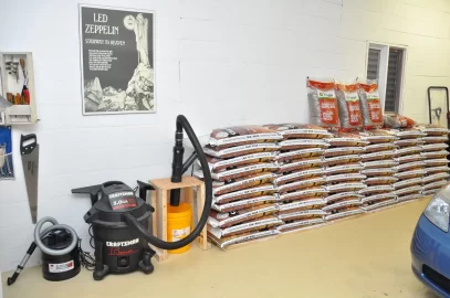

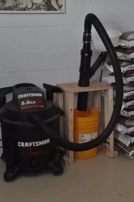

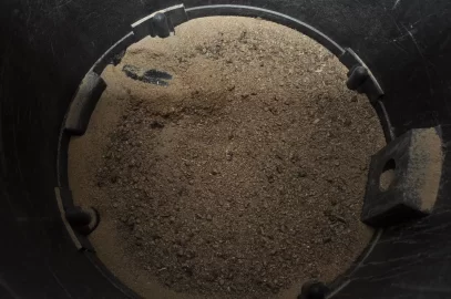

Here's what the Pellet Vac looks like near the stash, and also a pic of what the bottom of my Craftsman shop vac looks like after cleaning approximately 14-15 bags of Canawick pellets:
Led Zep eh? *grinz* Ah the memories...
