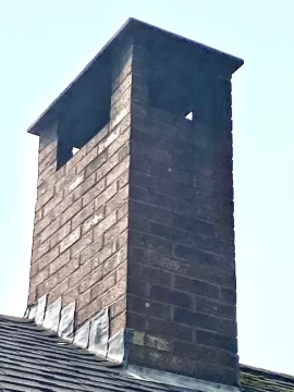

Thanks for the info, Don! A few details: My installater (from Higgins Energy Alternatives in Barre, MA) said I didn’t need an OAK, and the Accentra 52i TC has been running well, although the house is pretty tight so maybe it would run even better with the air kit. In any case, I don’t know if they did a separate air intake liner such as you described. As mentioned, the stone chimney cap doesn’t seem to allow staggering flue heights (see pic); I’m not sure it’s worth making expensive modifications up there. I called Higgins and explained my issue; a guy there suggested that the ceramic lined flue I’m pumping basement air into could have masonry issues and might allow crossover into the fireplace flue lower down, as opposed to a downdraft up top. This assumes the pellet stove flue’s SS liner isn’t sealed to the masonry near the fireplace. It makes sense, as I’ve never smelled basement air near the fireplace when running bathroom exhaust fans. If that’s the issue, I could seal around the SS pipe (if permissible) or just exhaust the basement air out a window instead of into the chimney flue.
Chimney design has changed dramatically over the years and unfortunately that design of having one top over multiple flues in the picture that was easy for the masons to install has now been deemed a bad design because it is notorious for creating and exacerbating down drafts!!
The latest design is a separate top for each flue with the wide downdraft metal band.
Updating it to the current design would be best for safety and efficiency and to meet any new fire codes. :)
