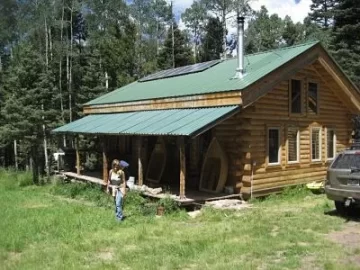

Try and post some photos of your system. Id like to see your chimney on the out side. Also inside too.

rkymtnoffgrid said:
I think the dutchwest is a qualtiy stove, I just am disapointed in the everburn system with it. I was sold that stove thinking I could utilize that clean burning technolgy buring the wood that grows in these parts. I burn pine and aspen, that's all I have, it's dry and seasoned well, but if the everburn can only be used by thoes buring hardwood that should be in the VC broucure on the VC websites etc. etc. It should be the first thing the dealers ask around these parts. We don't have hardwoods growing anywhere in the state! Now that I've owned it for 3 years, like the other gent here, I have tried eveything but can't get the everburn to stabilize for any length of time. As soon as the bypass is closed, the stove begins a slow process of looseing heat. It may it an hour, may take it 30min, may be 10, but it always stalls out. I've been told over and over that it is the wood that I burn, that I have to have hardwood...well VC should put that in sales liturature because the stove is worthless to us in these parts if you can only burn hard stuff. Now, I totally disagree with the quality of the stove being bad, besides the everburn never burning, its been a great stove. I guess this is my question....does anyone consistently achieve everburn with Aspen and Spruce? I understand you would have to load it more, but why wouldn't it work? If it not the wood then is it either my install, the sove being dirty, or my elevation (10,000ft)? I've been following this thread with great interest because this poor guy sounds like me last year when I gave up on trying to get the everburn to work. But unlike me, I doubt he's at extremely high elevations, and hes buring seasoned oak! I would think he should have no problem. I'm going to post two pictures of my inside and outside flue, since all the interested parties are already tuned in, maybe there is something obviously wrong they might see. This has been a great thread for learning exactly how to fire these stoves. Two picts are attached.
Maybe the everburn system would work better if the stove wasn't installed on its side. ;) :)
Your Chimney looks great, long and straight, I thougt it was ecocavilier that was having the issues.
