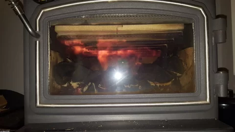

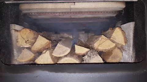

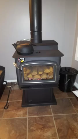

I happen to have your sibling the S2400 what I did last night was load her ¾ up at 9:30 pm with 11 3” splits placed on a bead of leveled coals.

At 9:47 closed the air by 50% the flames slowed substantially (lazy)

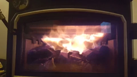

At 10:00 closed the air down 50% (lever pushed in ¾ of the way) as the flame intensity had picked up again.

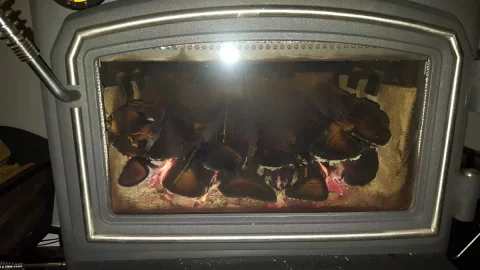

At 10:10 closed her down 50% (push lever in till ¼ inch showing) for the final adjustment of the night. Stove top at 500* with the fan on low and probe thermometer indication 300* flue temp.
[Hearth.com] East/West on Bottom? N/S on Top? (And pallet question)
At 10:30 she was cruising along at 600* stove top and 400* flue temp not much flame from the wood but good secondary flames taking place.

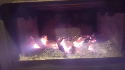

I woke up to coals at 6 am, gave them a stir and carried on with 3 big pine splits.
