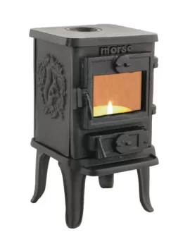

That 2B is a really nice-looking stove... but the firebox is so teeny... I wonder how they get primary air to the back of that thing?

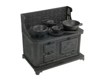

I told the wife that once I set up our daughters doll house I am getting a mini woodstove and that cookstove off the Morso site :)
It will be the only Morso-powered doll house, for sure...
I just asked for the 2B candle holder last night while watching TV. Dropping some hints for the perfect valentine's day gift!

I would bet my wood pile that there are a few Doll houses around with these in them.

  • [Hearth.com] East-west stoves and 'reversal'
