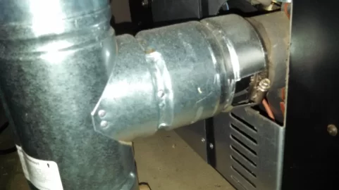

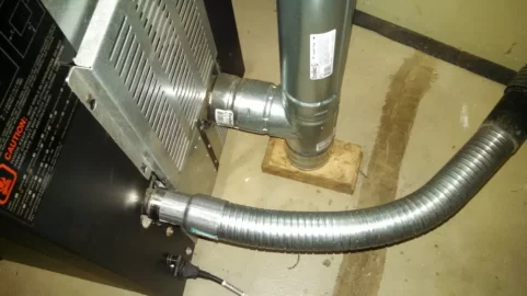

FWIW - I recently acquired a Laura stove and had the same issue in that the Duravent appliance adapter was slightly smaller diameter than the outlet on the Ravelli. As a temporary fix, I drilled out the rivets on the appliance adapter and separated the inner and outer pipes. I then widened the inner pipe to fit over the exhaust with still enough material to overlap. Then riveted the adapter together back with the larger opening. When I connected the appliance adapter to the stove I used a SS Hose clamp to secure the two snugly. It is working fine, just a thought.
Enclosing a couple of pictures..

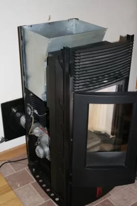

Glad you did get the right part. From the picture, I'd say you have the unit pretty well dismantled.... I have a sheet metal program for our cnc plasma table that will generate all sorts of HVAC parts from galv sheet that I never use. It's dusty software foir me....

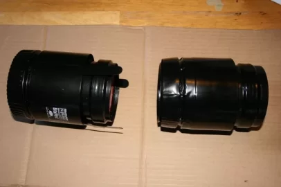

I had called the Credit Card earlier ... wouldn't have been able to do anything until Monday anyway. 3 calls now to speak to the owner, finally got him today and said he would check into it. I have sent his customer service rep emails with photos of what I have received both times with the final photo being the part they sent me next to the one the manufacturer sent (Edit along with the photo of the box with the original part number next to the part received). Service rep said no to reimbursement of shipping - will see what owner has to say. Don't think the service rep showed him the photos I sent...
Here's the scoundrel causing all this trouble:mad: He's the one on the right!
