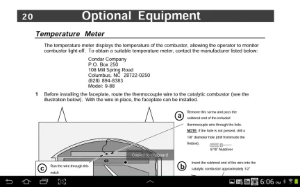

There is a electronic probe from Condar. Should show it towards the back of your owners manual. Page 20 in the owners manual I looked at. I agree I wouldn't worry about it, but if you are into gadgets there you go.
  • [Hearth.com] Elite 44 Catalytic Burn Off
Unfortunately like most cat stoves, the cat probe is an ackward option. Many of them aren't very practical or easy to place. With this unit you won't need it. You'll have it down in no time!
