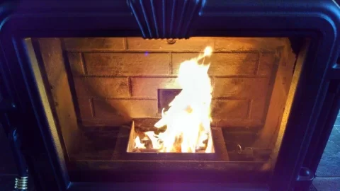

freshly cleaned and this is ten minutes after it went from startup to running. Set at 9 and 9 I am getting 172 degrees now and it's 15 minutes after going from start up to run. Its been fluctuating between 170 and 175 for a few minutes now.

It is all in the flame its color and the activity of the pellets in the burn pot. Your flame looks decent and you need to talk to someone who knows how to tweak those settings that you didn't provide a reading for. They sometimes need to be changed, ESW wants you to talk to them first. They change the base fuel/air ratio the stove uses to control the fire.

Just keep an eye on the stove for things like pellets piling up in the burn pot or very tall yellow flame - you may get good heat from such a flame, but you want a controlled lively bright burn with pellets never completely covering the stirrer shaft.
