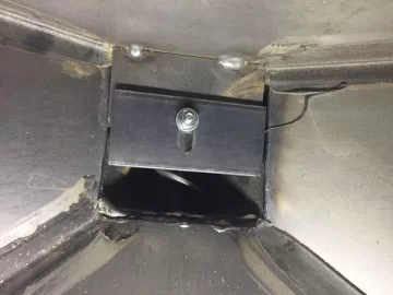

Didn't get a chance to make the restrictor plate yet, but I emptied the hopper and drew up a quick idea.
Installed the Hillman plugs. There are two - 3/4" bottom of the pot, and one - 3/4", one - 1/2" on top of the pot. At the bottom I had to grind one edge of the plug flat so it would fit, the hole in the burn pot is right at the bottom.

Didn't put much pellets in, and worked on the restrictor plate while the stove cooled down. Going to fire it back up with the restrictor limiting the flow to the top auger a bit, and see what happens. Snow is flying here in Upstate NY, and I need heat pumping in the shop! Hoping this does it!

I still can't help but wonder why this stove didn't have that restrictor plate in the first place. Also remember you can turn down your low burn feed too to reduce the fuel flow. With the enhancements to the air flow through the burn pot this adjustment might be all you need. Besides even with a taller flame as long as the pellets are burning properly now without mounds of red lava and unburned pellets/clinkers it shouldn't matter. The default 6 LBF might be a bit high for the pellets you are using if they are shorter in length they will feed a bit faster.
Also are you running the stove on C mode or D? As I understand it those stoves are supposed to be on D. C will feed more fuel.
My worry now with that restrictor plate in there the pellets will bridge the auger over time and starve the feed completely and putting the stove out.
The flame height being tall doesn't matter. The heat does. The PDV is built like a battleship. In C mode, you'll have heat to spare. My bottom three buttons are set at 6-4-1. Closing the restrictor plate never put out my fire, even on 1 or 2. You'll have to experiment to see what position works for you.
What really matters is that the stove burns properly and cleanly which it wasn't doing before.
