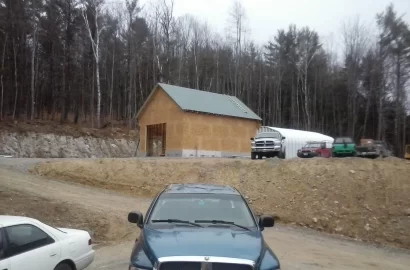

Hi guys, I just finished a garage build and I am going to heat it with wood. Looking for some advice on garage specific stove sizing (single room), I searched and could not find much.
A few points:
I want burn times but do not want to be cooked out (like everybody....haha)
clearances are not a problem
I work full time in this shop (live on property)
pic is a few months old, shop has 2 windows on the bare wall now
shop size 22x30 (660sq ft)
r19 fiberglass in walls, r49 cellulose in ceiling, r10 foam board under concrete
12x10 overhead door, 2 man doors, 2 windows
Any advise?

Howdy Tech,
You have a VERY well insulated garage, I must say. Wow! As many wise members here will tell you, THAT is more important than just "oversizing" a stove.
