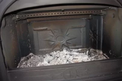

Your response epitomizes the misunderstanding that prevails about clean combustion technology. There is absolutely no need to "hold heat" for the next fire if the lining is lightweight and has good insulating properties.
Jotul has proven that you easily design a 75%+ efficient stove with a cast iron firebox. The cast iron is used to protect the fire brick behind the panels. You can beat the crap out of the inside of the stove with your wood with no risk of damage. It adds thermal mass and has the same thermal expansion as the rest of the stove. Finally, it adds an element of design as you can see the cast star and signature in the back panel of the F 400. As the fire burns down, this looks really cool through the glass. I much prefer the full cast iron lined Jotul's for their durability and aesthetics. Whenever I look at a stove with exposed firebrick I feel like I am looking at the inside of an industrial kiln = blech. With a smaller stove like the F 400, you can really cram a lot of wood into the fire box without having to delicately place the logs and worry about cracking, chipping, or wearing your fire brick. That has value, affords ease of use, and adds longevity to the product. This is exactly why you still see pre-EPA cast iron Vermont Castings stoves running today. They were built like battleships.
