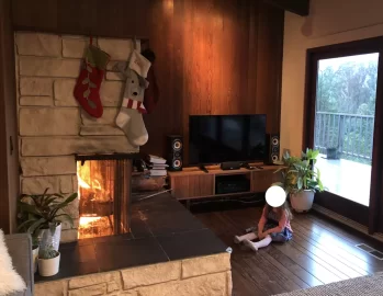

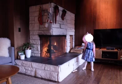

We're removing our 1961 corner fireplace monstrosity (fireplace, hearth, everything) and are excited about regaining a good chunk of our living area. Looking to add a compact woodstove. Primary heat is a gas furnace but efficiency is still at the top of my list. We get lots of 50 degree blowing fog in the summers and I would love to light a fire on occasion without guilt.
Stuv 30 is interesting as it only needs 8" of clearance. Still, while a vertical, rotating stove is intriguing, we'd still have the same problem of the fire being directed out our sliding window vs. into our room. I love the look of our original fireplace but inefficiency aside, who's idea was to orient the entire thing out a window?!
