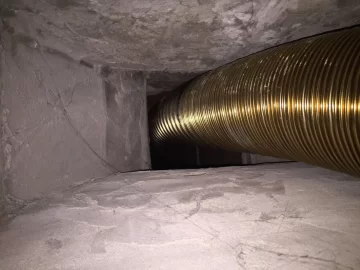

Just pulled the block off plate it looks like I should have enough room to insulate my liner.
  • [Hearth.com] F55 or Quadra Fire?

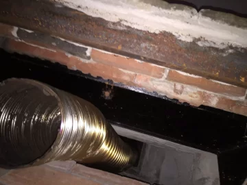

It does get tight by the damper. I should be able to leave the wrap short and the stuff roxul the last foot or so, correct?
It does get tight by the damper. I should be able to the the wrap short and the stuff roxul the last foot or so, correct?
Yes.
