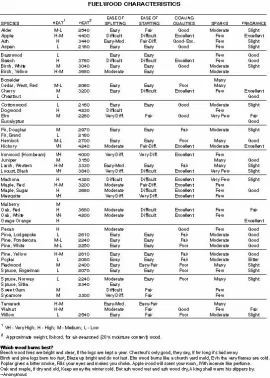

I'll thow another BTU chart on the fire.
